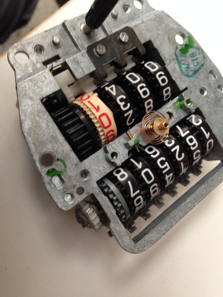

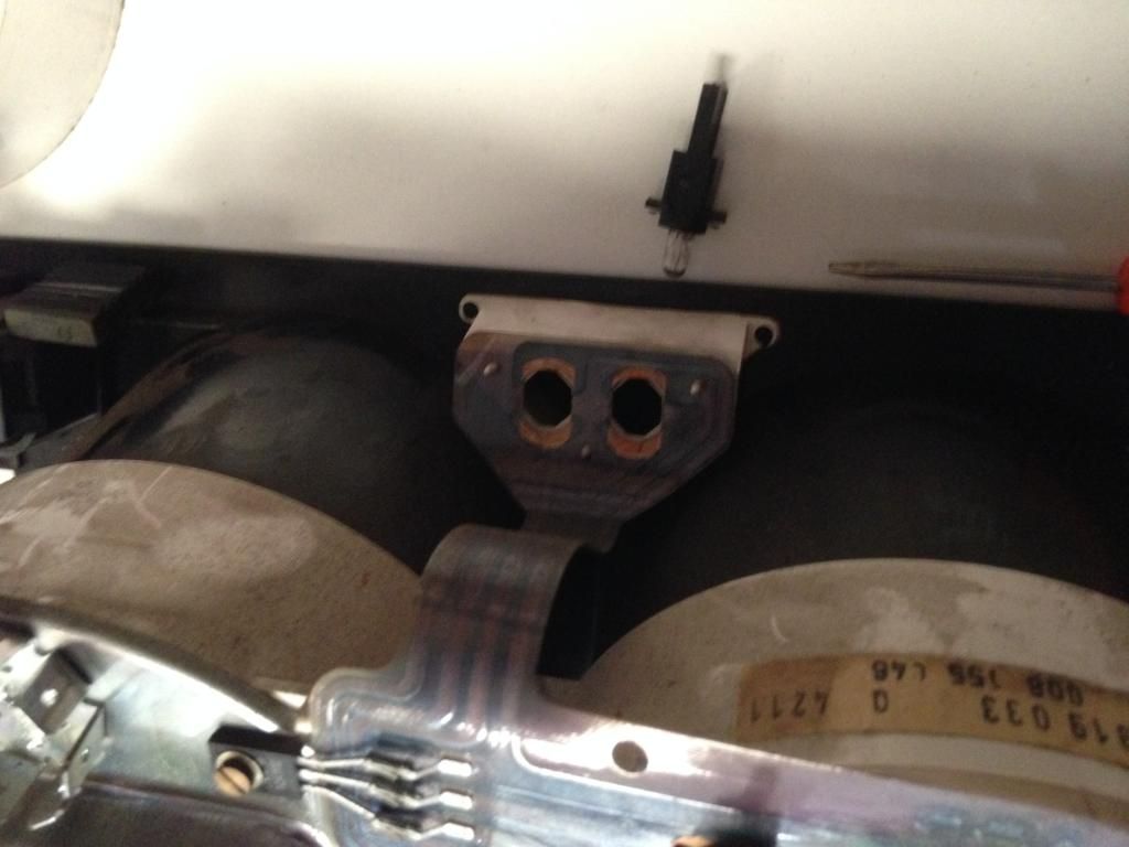

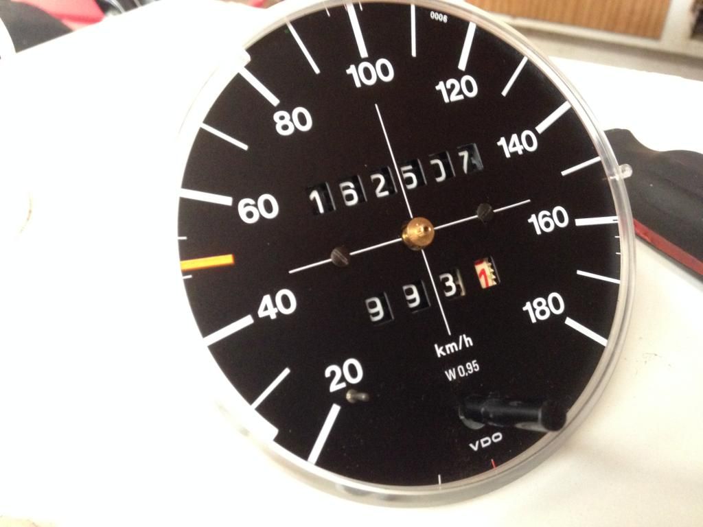

This week I have been doing two things to Andy
1. Getting all the parts ready for the 5 speed conversion.  I have purchased a linkage kit, 90mm drive flanges and a few other bits and pieces needed to upgrade.  I am just cleaning up the box now, I was thing about painting it, but the aluminium has come up looking fresh and clean after a little kerosene and toothbrush action, so that will be all that is needed.
2. The odometer stopped working randomly a little while ago so I pulled the cluster and set about repairing the issue.  Here is a write up with photos to help others and also for my own reference:
Once you have the gauge cluster removed from the dash (refer to Haynes or Bentley) this is what you are left with:

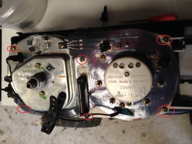

Set yourself up on a nice flat surface, you will need Philips and flat screwdrivers of various sizes as well as a set of sliding jaw pliers and some little picks/tweezers.
Undo the 6 screws circled below:

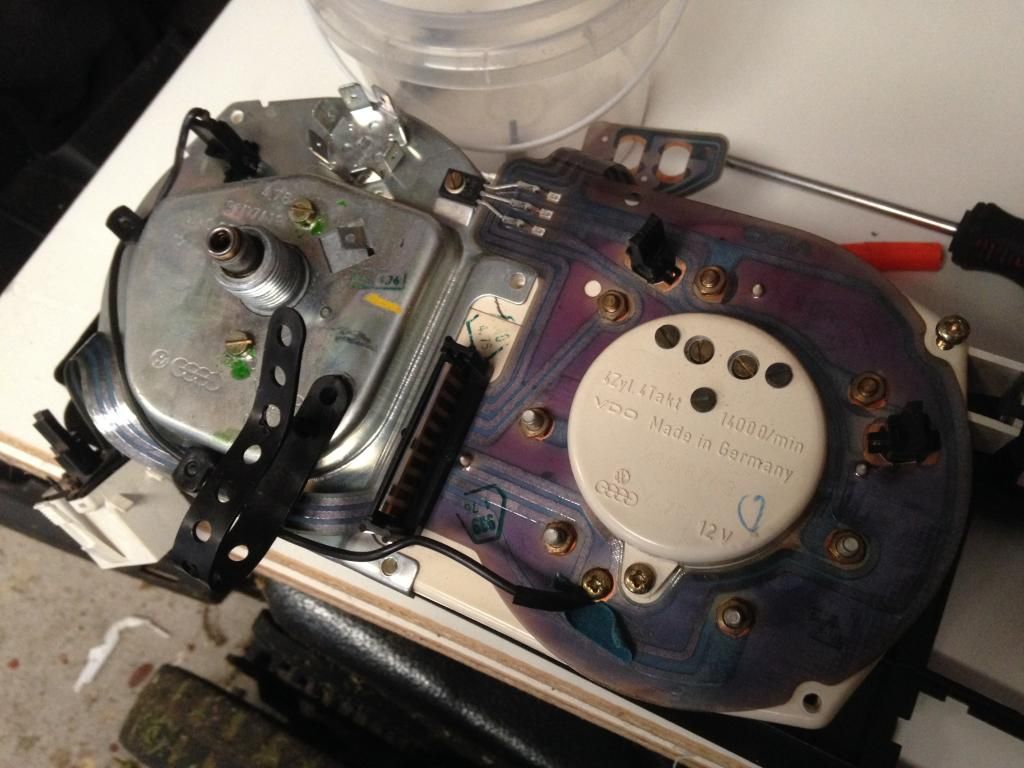

You need to remove 4 bulb holders to free the printed circuit board (bulbs shown in next 2 pictures).  This will allow you to remove the tach and speedo from the cluster housing.
Now you need to remove the speedo from the tach.  This requires the removal of the 2 screws highlighted below:
Now you should have the speedometer free from everything else.  Be VERY careful not drop it or lose any screws, etc…..
This is what you should have in front of you now:

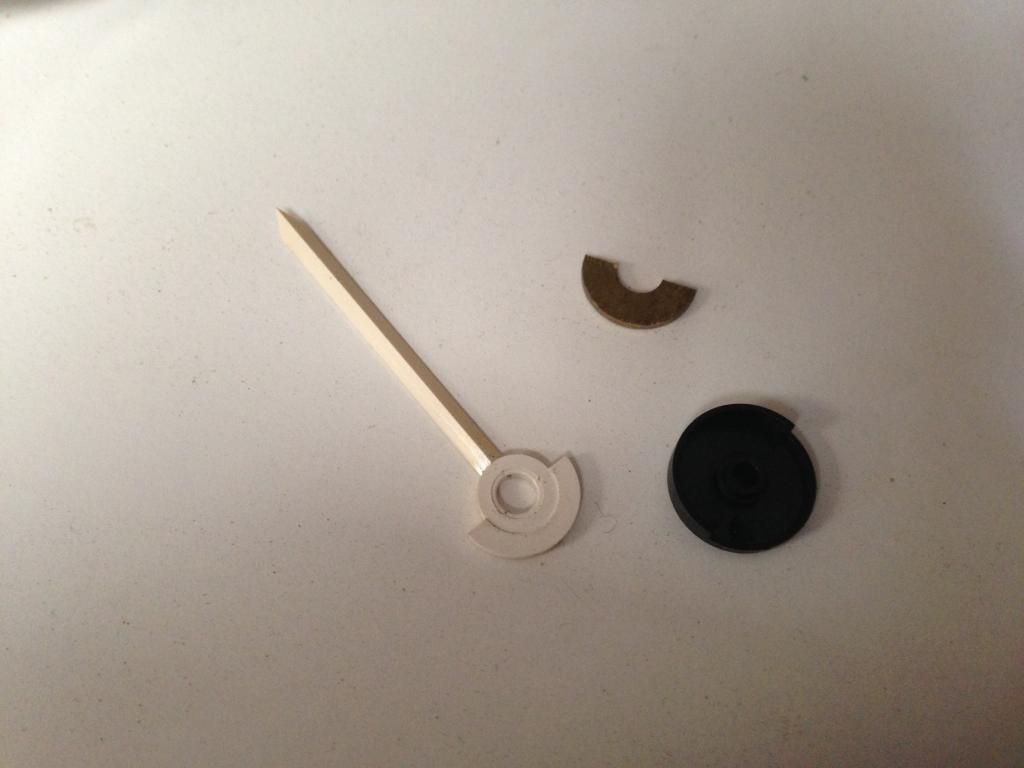

Remove the needle by sliding the tweezers/picks under the base of the needle and pulling up gently.  It will come free with some persuasion.  The needle will fall apart into 3 pieces, like such:
Now undo the 2 screws on the gauge face, make sure you don’t scratch it!!

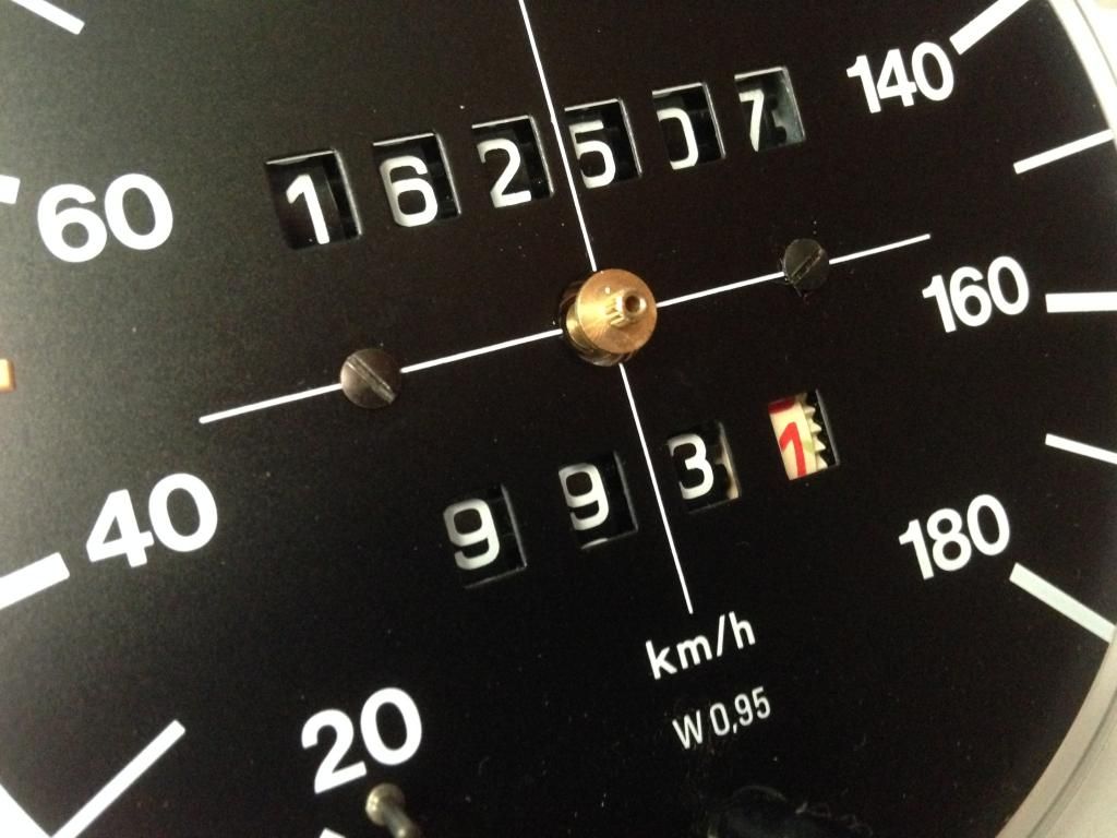

You now have access to the inner workings of the odometer and speedo.

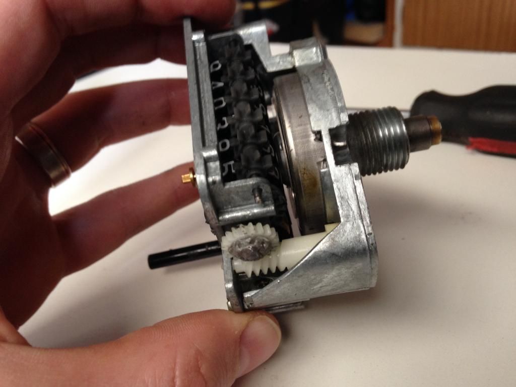

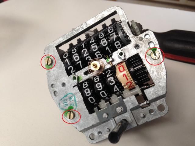

To allow you to access the gears and tumblers, remove these 3 screws CAREFULLY.  A white gear will drop out and you will also have to be careful of the speedometer flywheel thingee.
The way the odometer works is that the little white gear on the end (covered in grey snot in this photo) turns the shaft which turns the big metal tumbler.  This in turn drives the odometer through a series of small gears and black numbered tumblers, as well as driving the trip meter via the tiny white gear.
The common issue is that the white gear on the end (the one with the grey snot) cracks and spins freely on the shaft.  I also found that the big metal tumbler was spinning free on the shaft, thus nothing was happening when the speedo drive turned.
To fix the small white gear you need to start by levering the gear off the shaft.  I used a small screwdriver and it came off quite easily.  I used 2 tiny star washers that I pressed  over the sides of the white gear and then covered them in JB Weld and let it dry.
To fix the metal tumbler I slide the shaft out just enough so the tumbler dropped out.  Don’t remove it completely otherwise the black numbered tumblers will fall out!!  I added a smidge of JB Weld to the centre of the metal tumbler and then slide the shaft back through.  Make sure no JB Weld is on any of the other components, otherwise the whole thing won’t work.
Once the white gear is dry and the metal tumbler is dry (i.e. it won’t spin freely on the shaft) you can start reassembly.  I used the sliding jaw pliers to press the white gear back on the shaft with a little JB Weld to keep it locked on.
Everything else is just the reverse of dismantling.  I would take the time to install some T5 LED bulbs in the cluster so you never have to pull it apart again to change the incandescents.
Further pics for detail
Sorry for the wordy post, hopefully someone finds it useful.
