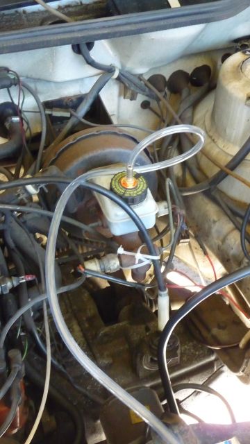

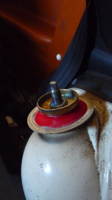

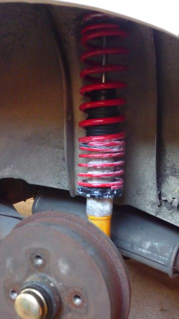

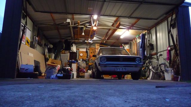

Last weekend I pulled all the old boat-like shocks out.  I have decided to switch to later style top mounts on the front, but unfortunately, the mounts I got didn't have the correct spacers and washers included, so I've spent the week tracking down the correct ones.
Today I got the rear shocks in.  Prothane top mounts and coated in lithium grease to protect the threads.

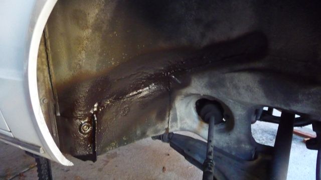

I also found some of the old underseal peeling off in the front arch.  So i ground it back and, using the por15 etching solution and por15 top coat, corrected the little bit of rust that was the present.  Then coating it in underseal, which looks like a cat with explosive diarrhea backed up to my car and let loose.

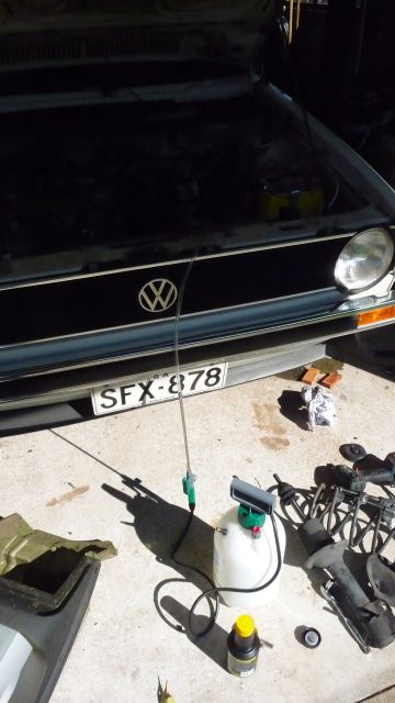

Finally, i used my homebuilt pressure bleeder to bleed the brakes.  It worked amazingly, managed to bleed all 4 corners, by myself in under 20minutes.  Build one, if you haven't already.

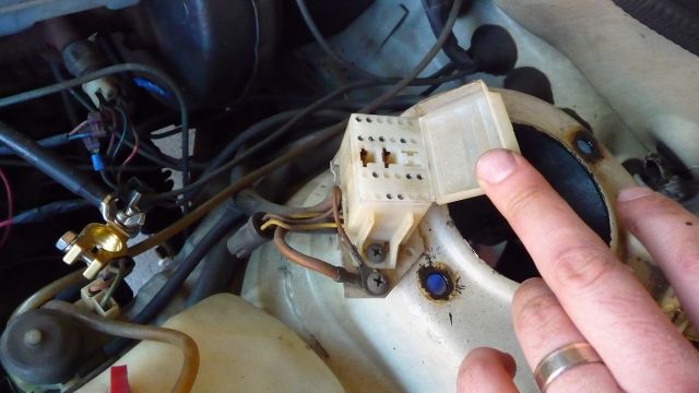

Also, what's this? Some kind of diagnostic hub?
"I am so clever that sometimes I don't understand a single word of what I am saying."

« Reply #53 on: September 03, 2012, 09:24:43 am »
Nice shed.
 I have a sales brochure of a mk1 golf and they show it at the VW service garage and they do have a diagnostic machine they plugged into a port where your one is.
 God knows what they can diagnose on an old points driven mk1 ???

I know! Plug it in...umm...yes, we can confirm your battery is flat.  Seems a waste of 450g of wiring.  Will see if I can hide it or I'll trace it back and get rid of it completely.
For anyone interested, this is the build instructions for the brake bleeder:
http://faculty.ccp.edu/faculty/dreed/campingart/jettatech/bleeder/index.htm
Mine came in $11 (sprayer), $6 (hose), $15 (brass fittings), $2 (tyre valve) = $34

Yep thats a diagnostic of sorts, checks lights etc..........bit of a gimmick in the day really. Came out on Beetle's first.

Don't delete It dubstar! Its part of its charm!
 Find an old "diagnostics" machine to plug into it!
 I will scan in the brochure.....

You will be able to suss stuff from it like Alt voltage etc with a multi meter. Bit like you can by touching one on the battery terminals but that's no fun is it.
 It was all about smoke and mirrors. Always has been and always will be ;)
