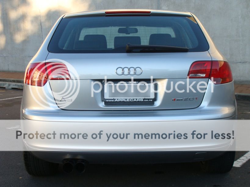

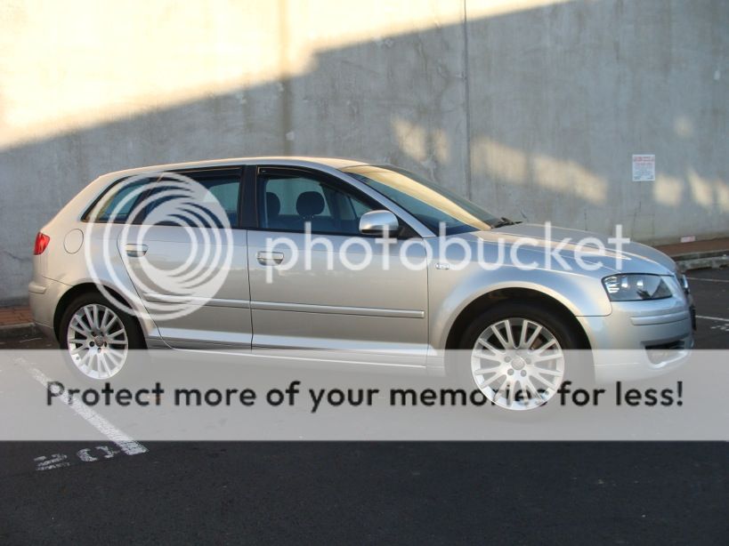

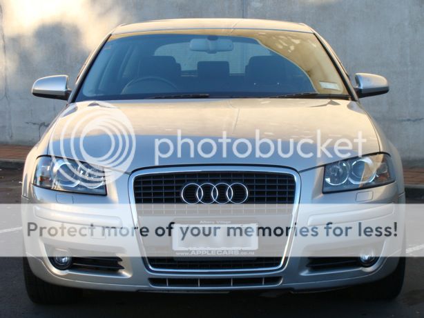

Here is a few pics of the car when I purchased it.
