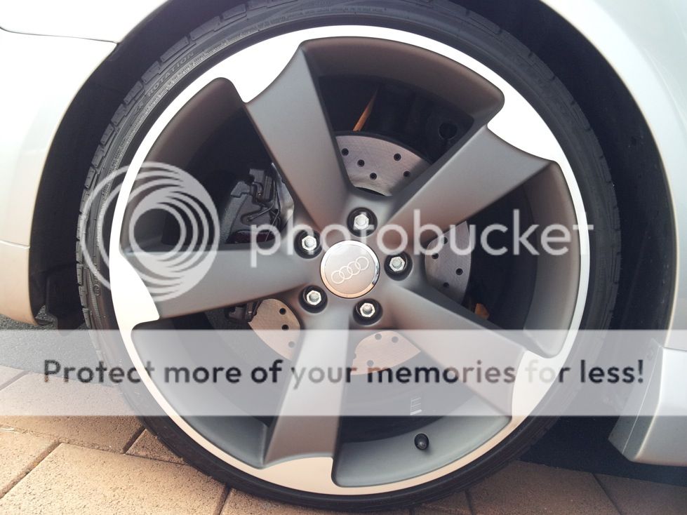

BRAKES - Would thoroughly recommend these upgrades to anyone who wants a decent upgrade in braking performance without breaking the bank.
The pedal feel and progression instills a LOT more confidence over the OE setup. Did a number of hard 60-0kmh and 100-0kmh stops to break the pads/rotors in and the car pulls up nice and quick without engaging ABS. I cant get over how much nicer the pedal progression is. Nice and solid and progressive right through the pedal travel. Very happy with it. Little dust now (Probably 10% of OE) and no squeaking/squealing at all when coming to a stop.
Note: The fluid that came out wasnt too bad, so im guessing the fluid was changed in the last 20,000kms or so. The OE pads had around 80% left on them. The new rotors wouldnt have made any difference to what I am feeling initially. The tyres I have are nice and grippy so this would also assist with hard stops.
Made a bit of a mistake when purchasing 286mm rear rotors. A3s and Golfs didnt change from 260mm to 286mm until 2008ish. Have put in a set of new OE rotors for now and will look at new carriers and dust shields to upgrade to the 286mm rotors at a later date. Calipers look to be the same between both.

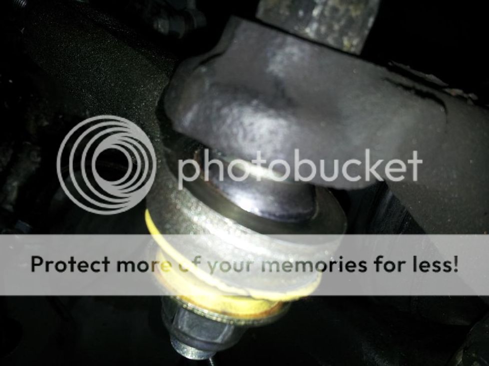

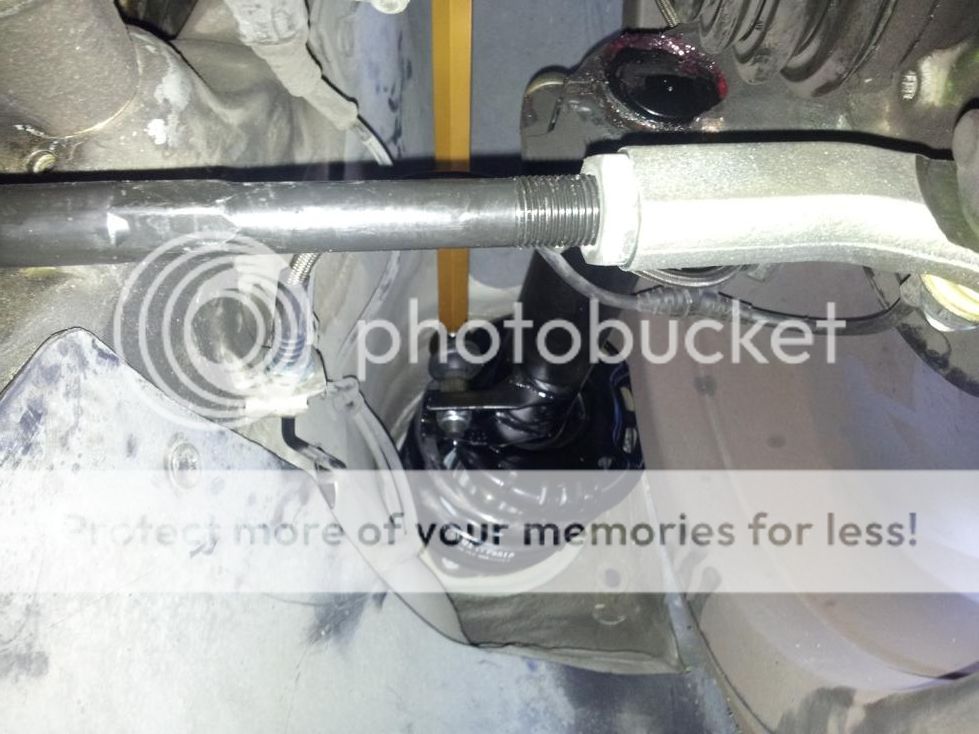

SUSPENSION - Firstly, the NVH and ride quality is now at the outer limit of what I am personally happy with for a daily driver. I wouldn't recommend going as far as I have if you value your ride quality over cornering performance and drive on bad roads a lot. I dont have much of a problem with it but I mainly drive on decent roads and only do around 6000km a year in this car. The combination of 35 profile tyres/19" wheels and the suspension upgrades do make for a hard ride. If you stick with a lower diameter wheel and higher profile tyre the harshness would be reduced quite a lot I imagine, even with the same suspension setup. A few rattles and squeaks were initially introduced, but a bit of WD40 and tightening a few screws etc here and there have tidied that up.
Now on to the good stuff.
Issues that are now non existent: No more subframe clunk or shifting whatsoever. You can give the accelerator a sharp tap at low speeds and the whole car will go forward, rather than there being a split second while the rest of the car catches up with the subframe. No more clicking when turning sharply at low speed.
No more 'compression' squeak/noise from the rear when going over bumps (Fixed by Whiteline trailing arm bushes and possibly new rear end links). When hitting a bump you feel it initially but it is dampened instantly and the car continues on its way with no after effects or bumping (probably mostly related to the correct dampers in the front now). No bump steer now either.
Steering feels a lot more precise and you can feel more of the undulations of the road through the steering wheel. Better feedback.

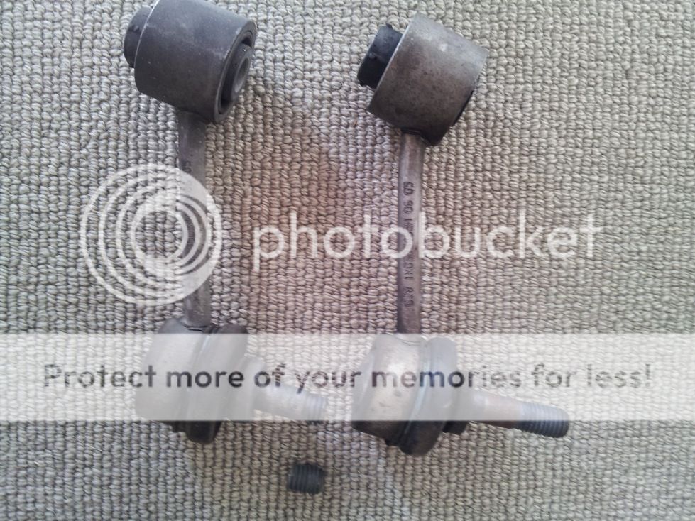

The rear end links also needed to be replaced as one of them was bent and the other had a seized bolt. Decided to replace with OEM instead of Whiteline as the application is slightly different in the rear and the links are a lot stubbier and therefore I imagine have much less load on them than the fronts. The one on the right is the bent one in the picture below. The rest of the photos arent the best but you get the idea. Will try and take some more when its on a hoist next.
Dont realise how many parts have been replaced till they are all sitting in a box to one side, most seem in ok condition and have no torn boots.
