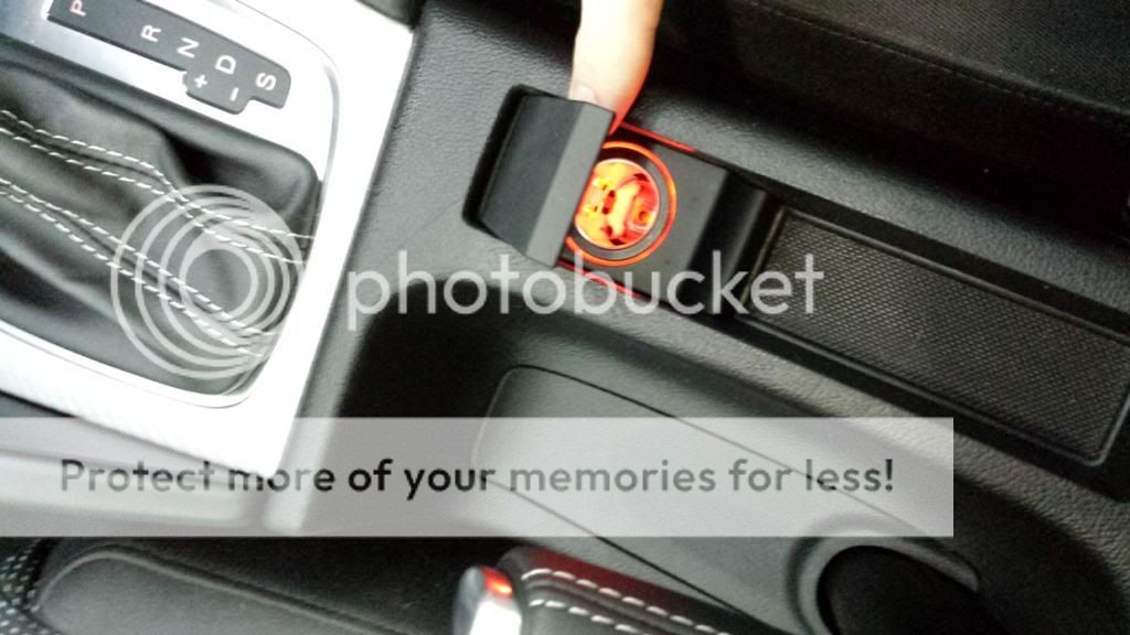

My cig lighter and trim was scuffed up and needed replacing so decided to pick up the 12v 'flap socket' from the 'non smokers pack' out of the Audi parts bin. I think this makes the centre console look a lot cleaner.
