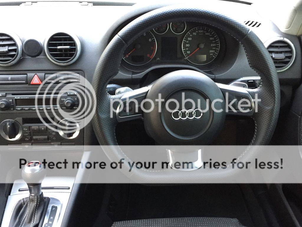

Found a TT Steering wheel and airbag on Ebay from a wrecker in Sydney last year. $350inc delivery which was a steal.
Its uncanny how much a good steering wheel transforms the way the car drives. I didnt have Multi function on my old wheel but I do have the highline module so the buttons worked with a little coding in VCDS which was a bonus!

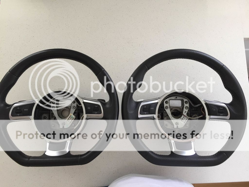

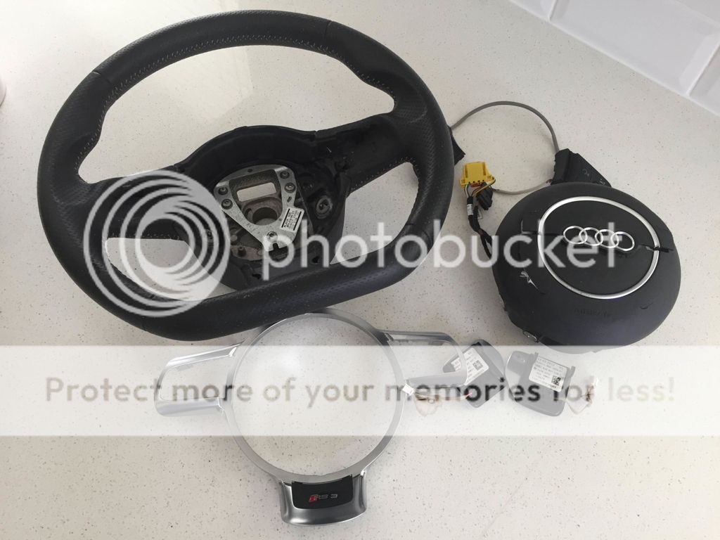

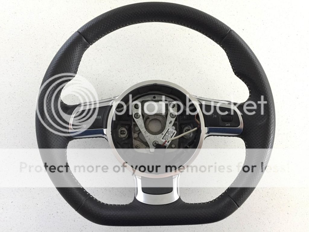

Picked up this RS3 steering wheel for a good price a few weeks ago. It was from a wreck and looked like it had been sitting in a dusty shed for the last two years.
The punched leather had dirt in the holes and the silver stitching was yellowed.
Started off using a light saddle soap with a toothbrush and cloth to clean it up, then a little shampoo on the stitching and finished off with a good leather conditioner.
Came up like new.

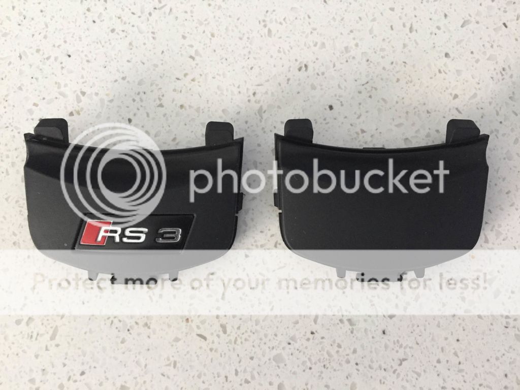

Decided to switch out the RS3 plate for a blank trim piece. The TT airbag I have is the same size with the same connections.
I also have a facelift (8P2) airbag cover with the chrome ring but I havnt had time to tackle that one yet. Need to be very careful when mucking around
with the airbag itself and have to use a rivet gun to fit it. Quite a few guys in the UK do the facelift airbag cover mod.
Main differences between this wheel and the Audi TT one I had are:
- Thicker wheel with better 'hand grip' and more aggressive look. 40mm diameter compared to 35mm i think it is.
- Punched leather (goes with the RS DSG gearknob).
- Silver/Aluminium S/RS DSG paddles
Really enjoying the different feel it gives the car. The silver stitching goes with the RS3 gearshift boot and S3 handbrake cover I have which is a nice touch.
