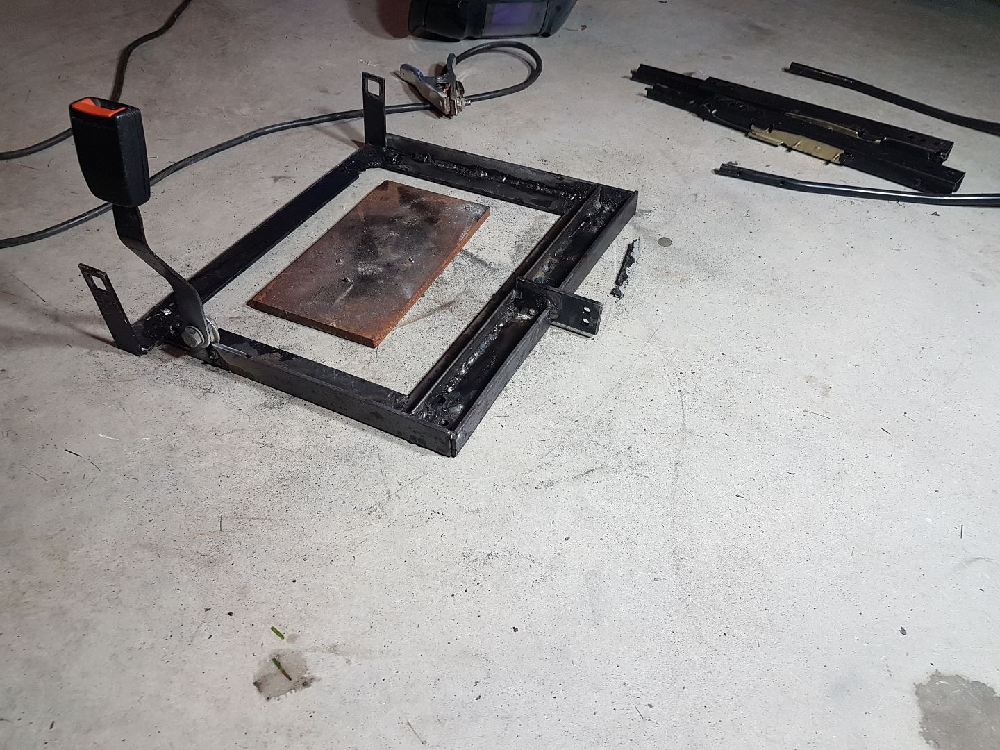

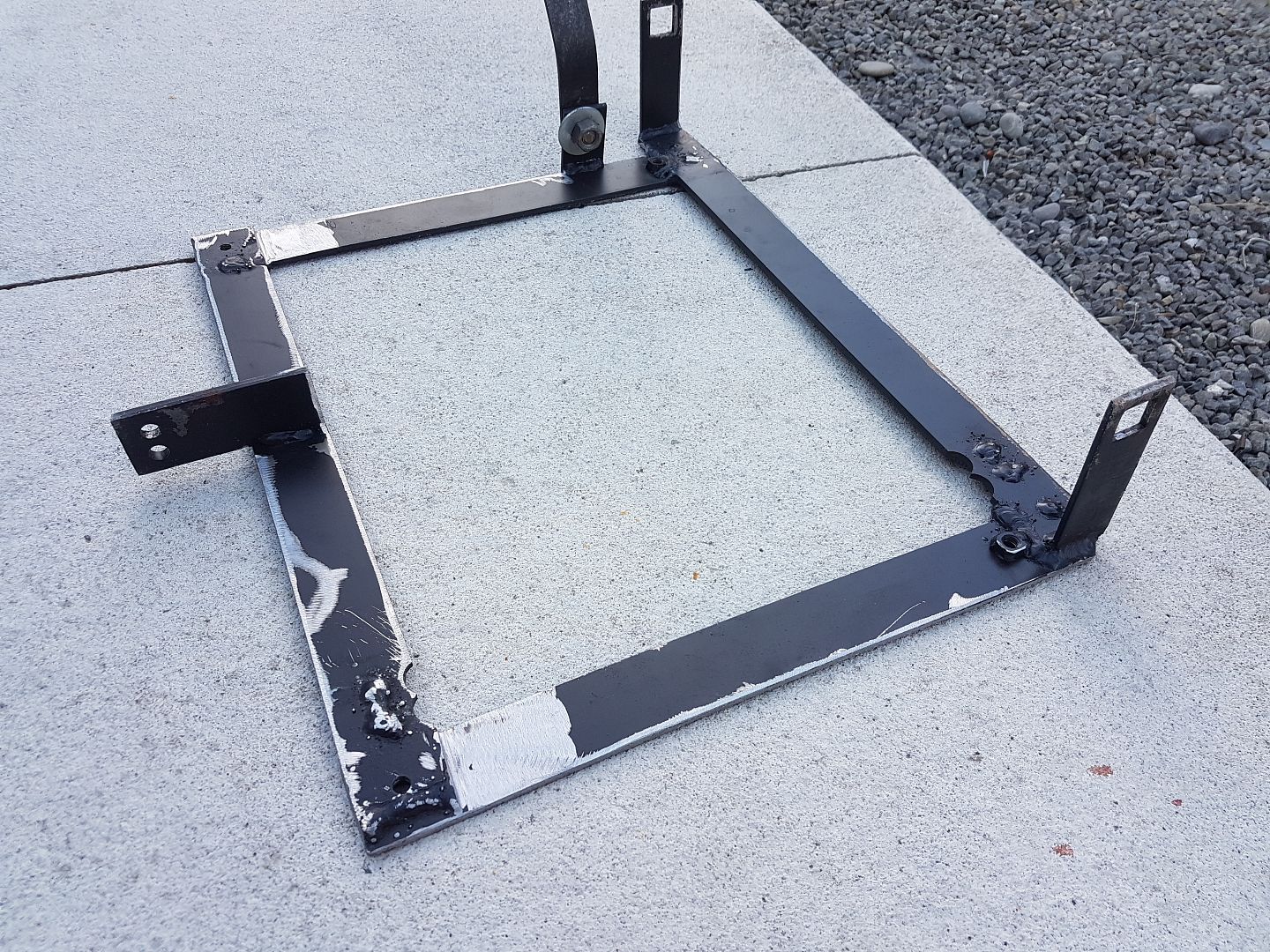

Keeping the ball rolling the seat brackets i purchased way back when, needed some serious attention.
FYI don't but these pieces of sh*t!
The front was bent like a banana, granted im 100kgs but come on a seat mount shouldn't bend in my opinion and I really wouldn't trust them as they were.
So i decided to beef them up a little with some old flat stock and EA that I had lying round..
Don't look too close at the welding its been a couple of years and im out of practice
Still have a couple of bits to attach to the back side, but already they are far stronger than before...
